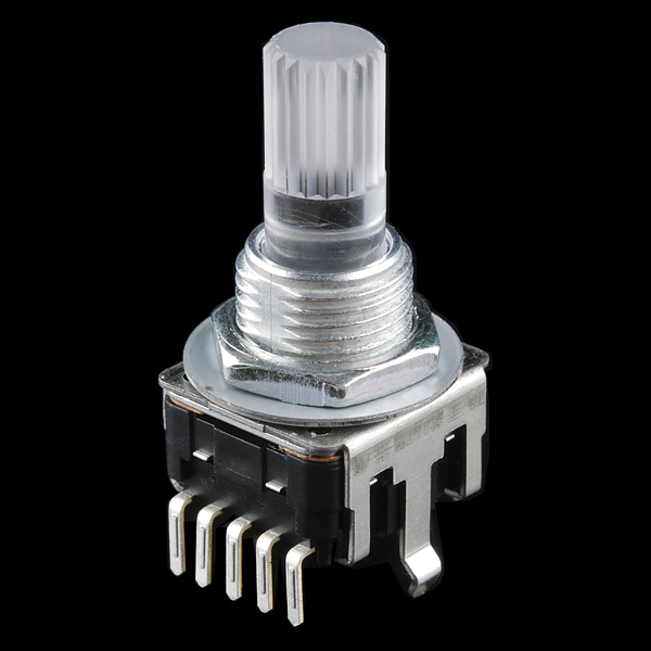

We're going to hook a few basic components to our Arduino, we've already covered the Big Dome button. Besides changing color we want to be able to modify brush width. This is a value from 2 to 128, so we decided a rotary encoder would be best, so we grabbed one of these Illuminated Rotary Encoders from SparkFun. These let us not only read a continuous stream of values, but they also have an embedded RGB LED that we can use to provide some feedback.
These encoders are actually a little complex to read, they only require two pins but you need to read their values very carefully to determine which way the encoder has been rotated. Here's a quick snippet of code showing how to use them:

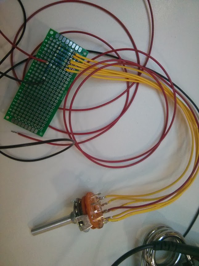

We also want to be able to modify brush shape, for this we have 6 values, so we grabbed a basic rotary switch from RadioShack. This switch would really require us to use 6 pins, one for each position, unfortunately we don't really have that many pins and it would vastly complicate our reading of the values anyway, so we came up with a quick hack using a simple voltage divider circuit and one of the analog pins to read a different voltage at each pin position.
Here's the code for reading the value based on a selection of resistor values, dead simple right?
int getBrush() {
int val = analogRead(BRUSH_SWITCH_PIN);
if (val > 950)
return 0;
else if (val > 700)
return 1;
else if(val > 450)
return 2;
else if(val > 250)
return 3;
else if(val > 75)
return 4;
else
return 5;
